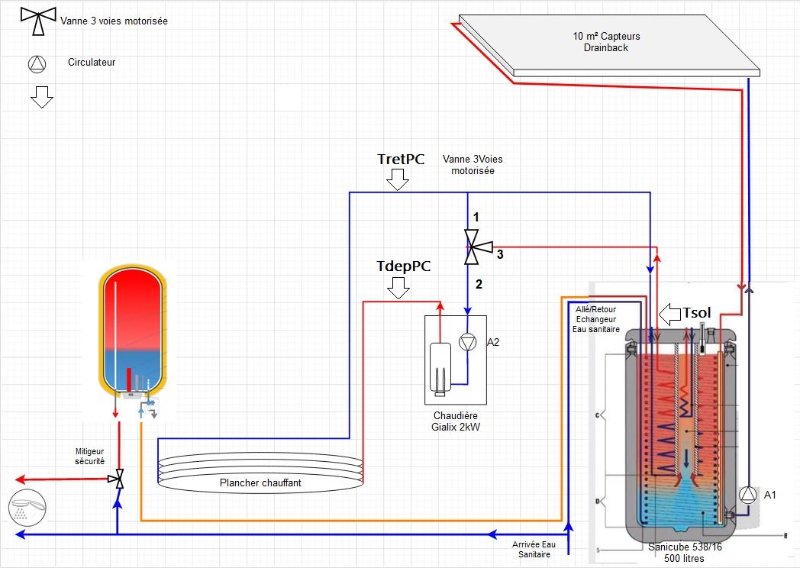

Tu aurais moyen de nous faire un schéma de ton installation ou la future installation ?

Voici le schéma de l'installation
et les Rules (programme d'espeasy du pseudo C)

On Rules#Timer=1 do
	Event,Circ_On
	Timerset,1,0
	Timerset,3,30 //300
Endon
On Rules#Timer=3 do
	If [TSolaire#T]>[var#1]+2		//si solaire 2°C> consigne
		If [TRetour_PC#T]<[var#1]	//si retour trop froid
			If [Etat_chaudiere#DMvt_V3V]>=0			//si inversion de sens de la V3V
				Let,2,5
			Else
				Let,2,[var#3]+5
			Endif
				Event,Ouvrir_V3V
				Timerset,3,[var#4]			//Tempo regul
		Else
			If [TRetour_PC#T]>[var#1]+2	//si retour trop chaud
				If [Etat_chaudiere#DMvt_V3V]<0			//si inversion de sens de la V3V
					Let,2,5
				Else
					Let,2,[var#3]+5
				Endif
				Event,Fermer_V3V
			Endif
		Endif
		Timerset,4,60				//Tempo compteur horaire
	Else
		Let,2,125
		Event,Fermer_V3V
		Let,2,0
		TaskValueSet 7,2,0
		Event,Circ_Off
		Timerset,4,0				//stop cpt horaire
		Timerset,1,3600				//tempo retester
	Endif
Endon
On Rules#Timer=4 do
	Let,5,[var#5]+1
	TaskValueSet 8,4,[var#5]
	Timerset,4,60
Endon
On Clock#Time=All,12:00 do
	Let,5,0
	TaskValueSet 8,4,[var#5]*10
Endon
Et la Rule2
Code : Tout sélectionner
==== ESP chaudiere ====
Rules 2
10/01/2022
//AFFICHAGE
On Rules#Timer=5 do
	If [var#16]=1
	event,aff_info
	Endif
	If [var#16]=-1
	event,aff_reglage
	Endif
	Timerset,5,30
Endon
On aff_info do
	lcd,1,1,AUTO
	lcd,1,6,Consigne
	lcd,1,16,[var#1]°C
	lcd,2,1,TDep
	lcd,2,5,[TDepart_PC#T]
	lcd,2,11,TRet
	lcd,2,16,[TRetour_PC#T]
	lcd,3,1,TSol
	lcd,3,6,[TSolaire#T]
	lcd,3,11,PosV3V
	lcd,3,18,[Etat_chaudiere#V3V_Pos]
	lcd,4,1,Nb
	lcd,4,4,[Para_Regul#Cpt_H]min
Endon
On aff_reglage do
	lcd,1,1,temp_Cible
	Timerset,6,10
Endon
On Rules#Timer=6 do
	Let,16,1
	event,affichage
	Timerset,6,0
Endon
//SECURITE
On TDepart_PC=-127 do	//si sonde HS
	Event,Circ_Off
	Let,2,125
	Event,Fermer_V3V
Endon
On TDepart_PC>28 do		//si depart trop chaud Stop
	Event,Circ_Off
	Let,2,125
	Event,Fermer_V3V
Endon
//Encodeur
On BP#State=10 do //LPress
	Let,16,[var#16]*-1
	event,affichage
Endon
On BP#State=3 do //DClic
	[enc#Counter]=-100
Endon
On enc#Counter do
if [enc#Counter] > [encodummy#Counter]
	TaskValueSet 10,1,[encodummy#Counter]+1
	Let,1,[var#1]+0.5
lcd,4,1,Plus
elseif [enc#Counter] < [encodummy#Counter]
	TaskValueSet 10,1,[encodummy#Counter]-1
	Let,1,[var#1]-0.5
	event,affichage
lcd,4,1,Moins
Endif
	TaskValueSet 10,2,[var#1]
Endon
//MVT V3V
On Ouvrir_V3V do
	If [Etat_chaudiere#V3V_Pos]<125
		timerset,2,[var#2]
		TaskValueSet 7,3,[var#2]
		TaskValueSet 7,2,([Etat_Chaudiere#V3V_Pos]+[var#2])
		gpio,19,1
		gpio,18,0
	Endif
Endon
On Fermer_V3V do
	If [Etat_chaudiere#V3V_Pos]>0
		timerset,2,[var#2]
		TaskValueSet 7,3,-[var#2]
		TaskValueSet 7,2,([Etat_Chaudiere#V3V_Pos]-[var#2])
		gpio,19,0
		gpio,18,1
	Endif
Endon
On Timer=2 do	//Arret V3V
	gpio,19,1
	gpio,18,1
Endon
//Circulateur
On Circ_On do
	Gpio,17,0
	TaskValueSet 7,1,1
Endon
On Circ_Off do
	Gpio,17,1
	TaskValueSet 7,1,0
Endon
